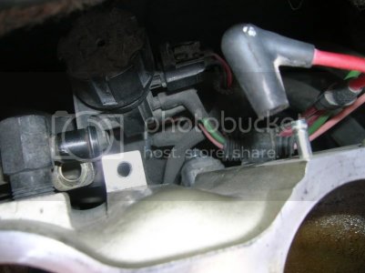

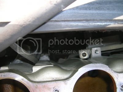

You need:
Sockets
8, 10, 12 mm
Combination wrenches
10, 12 mm
Standard Screwdriver
Pliars
DSCN0843
Left side surge tank bracket bolt
DSCN0844
Right side surge tank bracket bolt
DSCN0847
DSCN0853
And 2-3 hours if it's your first time tearing it apart. Don't lose the metal gasket that is behind the egr.
