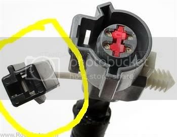

Troywakeling
Nov 27, 2005
202
40
Winterport, Maine
Well one of the issues is that the connector circled in yellow below is stripped and unplugged. What does this secondary connector do? I spliced a terminal end on it and plugged it in. Havent noticed a difference yet though. If its plugged or unplugged the car starts fine with no CEL and the tach is working. Im going to replace it anyway though, I found a brand new Crank sensor in the back seat in a new box.
