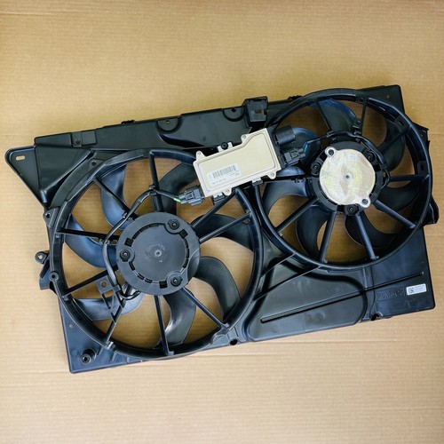

I have a 2010 SHO. On two occasions, I have experienced overheating while idling. The problem seems to be intermittent. I believe this is being caused by one of the radiator fans not working correctly. I have noticed that the fan on the driver side seems to be running normal. The fan on the passenger side seems to be sluggish. In fact, the other day I reached down and gabbed the fan and it stopped spinning. Any idea why one fan works normally and other does not?

Just double checking here - have you recently changed the coolant? Could just be a bad fan - if you have Forscan you could see if you are logging any errors.

I am having the same problem with my 2010 sho. So far, I checked the fan by running a wire from the battery to the fan. It worked fine, it actually spun fast. I replaced the fan control module and it is still doing the same sluggish spin or it would stop. I have read somewhere that the problem could be the cylinder head temperature sensor or wiring to the sensor. That involves taking off the lower intake to get to it. I have not done it yet but I would like to know if anyone has done this and how difficult is it?

Ok guys, just to follow up. The sluggish fan is a bad fan. Both fans work together when the a/c is switched on. So if one is slow and the other isn't, change the fan. I changed my double fan and it made a world of difference, I can even feel the difference in performance because the engine is running at a cooler operating temperature. It took me a while to figure this out but at least the problem is solved.

The 2010-2012 fan models are a PIA whenever one is bad (at times) the whole fan assembly has to be replaced. For 2013-2019 models when a fan fails it’s possible to fix it by replacing the clutches.
I wish SPAL had a drop-in, PCM controlled upgrade so people living in real HOT climates can have a little peace of mind. OEM fans are noisy already so bring on the SPAL noise.
