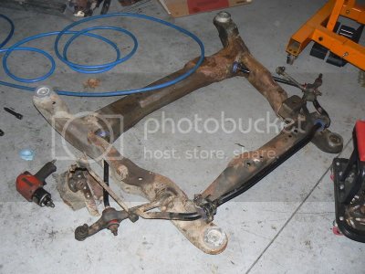

Ok.. I got under my car for the first time in a while to replace a tie rod, and my LCA's. When I was looking at the strut rod in the front of the subframe, I was wondering how "smashed" that bushing should be. I got the blue MOOG bushings and they seemed to fit ok. I tightend it up with a 3/4 Impact even as tight as it would go, but it still seems like there is a small gap there. I didn't see anything as far as the cup rusting away from the subframe, so maybe its ok?
This clunk when letting off the gas, or stepping on it is driving me nutz! Everything *should be ok.. almost everything is new.. Maybe I just have a MM that is seperating and I just can't see it? When I have it above 2500 rpm in gear, and let off the gas in a hurry, it thumps like a MM.
I'm thinking its almost got to be the motor mount, even tho its a reinforced one, I think its failing. I got it from a shocago member years ago, and IIRC the only thing special is the larger sleeve instead of the bolt thru the middle. But I guess the rubber seperating could still be an issue with these mounts correct? Man I can't wait for warm weather...

Hope this helps , I dont have a pic of the front though.
Another angle

P1040164 1
Thats the only pic I have now.. I'll go out here in a few and see if I can get some more. I just got my LCA's installed yesterday, so Ignore that red bushing garbage in this pic. But mine are about as tight as you had em in that first pic. I just wondered if that edge there was supposed to be "squished flat" and not as visable maybe? I used a 3/4 Impact on that front one, with a wrench against the concrete floor.. so believe me its as tight as I could get it.
My problem must be that motor mount then... :( can't belive I smoked it so fast..+
Edit: I replaced that tranny mount in that picture too.. if u were wondering.. ;)
