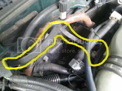

2011 06 14130533
The ground strap.

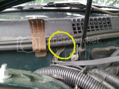

2011 06 14130429
The ground location on the firewall.

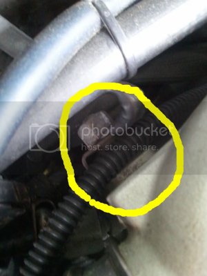

2011 06 14130633
The stud that holds the ground strap in place on the intake.
