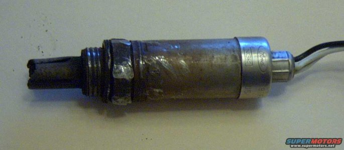

Don't change the post cat sensors. They only tell the PCM if the cats are working. There is no engine control connected to them.
The OEM O2s are NGK. FWIW
O2 w nkg frod logos
