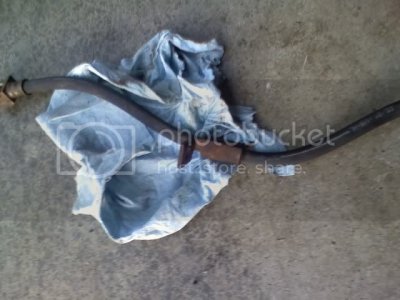

Thats the exact same thing I need to know.
Your talking about the bracket thingy in the middle of that line right?
0725092019
I have it all set to go but I also need to know if you just swap over the old bracket or if you can buy a new one.
0725092106a
I figure it would be best to get a new one and if you can't then use the old...but the old line doesn't want to budge out of the old bracket. :bonk:
Did you have a lot of trouble making the fitting fit?
blacklabel
Feb 28, 2005
609
22
Hartford, WI
Well i Used my dremel for the bracket for where the hard line meets the SS line. The slant on the stock rubber line is at a different spot than the SS line. I just sanded down the bracket little by little till it perfectly fit.
Also for the bracket that bolts to the strut, today i cut out the old rubber line with the dremel. Then it was heated up and spread a bit to let the new line in and secured the line with tie tie.
