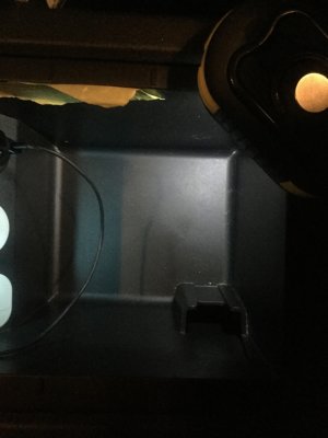

Not sure about the 13+ but my 2010 has a spot in the center console were your supposed to put the fob durning communication issues.
I've used it once durning a low battery issue with the fob.
5468ea394e007949e3f1d42572fafde2
Behind this rubber flap.
F06d2b5dc54a4e2b6ea8257390da3faf

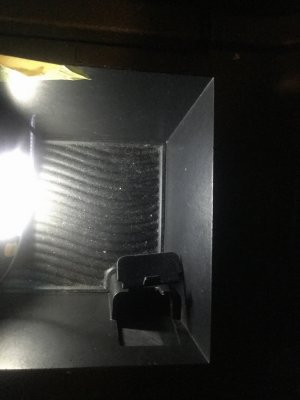

That spot is in the glove box on my '13 MKS. Took a lot of research to figure that one out since there's no mention in the owners manual.

That spot is actually on the underside of your center console. Open it up and look at the underside. I had my car a year before I realized all those storage spots were there.
