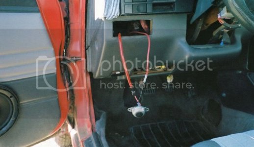

i have on on my car and all you need is a high amp bush button for an auto parts store and some wire. i have my button hiden in that little comparment in fron of the shifter. take on end of the wire and conect it to the small post of the starter solinoid on the fender under the hood and the other end to the bottom main terminal of the solinoid. then just run your wires to the button thats it.
