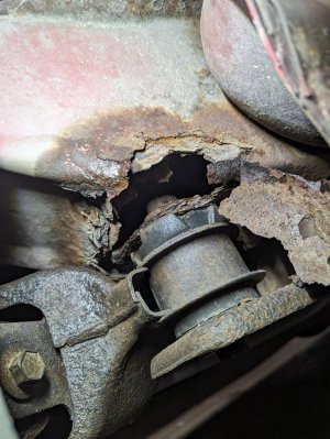

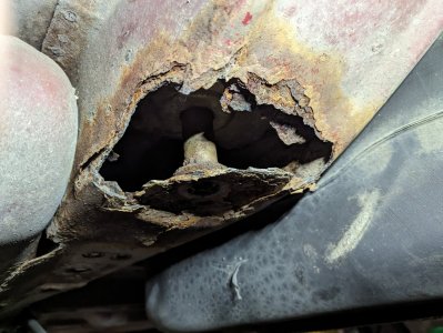

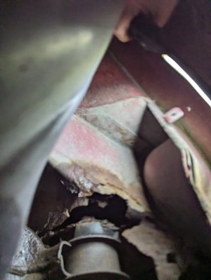

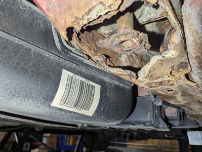

So I picked up a nail driving through a construction site on the way home from work today. I put the car up on jack stands to find the tire damage and while doing so, this rust caught my eye. It is hidden up behind the rear wheel liner so I had to remove that to get a good look. It is where the rear subframe bolts to the body under the rear doors. The car appears nearly rust free otherwise, so this may become a trouble rust area. If you live somewhere they salt the roads, you may want to give this area a look over.

My uncle is a professional welder and he said he thinks he can fix it, so rather than just scrapping the car, we're gonna give it a try. It is gonna remain parked for now though.

holy sh--it that is really bad. I'm glad you caught it before something happened at speed.
The problem is getting to solid metal to weld to. How much rusted metal needs to be cut out?
Metal looks solid just a few inches in each direction, so hopefully not too much needs cut out.

It is the point where the rear sub frame mounts to the unibody of the car. There are 2 large bolts that go through a bushing in the subframe and into the body of the car. That bushing is the one in the photos.
No undercoating. The rubber undercoating can seal in moisture and accelerate rust. I did plan on having it Crown'd or Fluid Filmed (lanolin oil coating) but never got around to it.

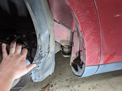

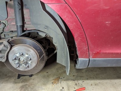

Just a couple more photos to give a better idea of the location. These were taken at the passengers rear wheel well.

I'm planning on picking up a set of quick jacks to lift the car off the subframe, but it'll be a 'when I get around to it' project as my schedule is pretty much full for the rest of the year.

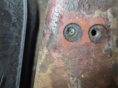

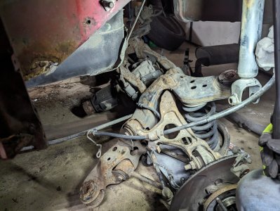

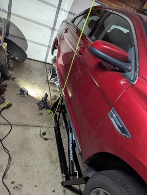

Got the rear subframe out and the bolts are sleeved through the 'frame rail' that is rotted out, so probably not as much risk as I initially thought. Dropping the subframe wasn't as difficult as I expected (thanks to the quick jacks) but a couple of the bolts for the "subframe reinforcement brackets" broke off in the body, so I'm working on those right now.
Wow....good luck
