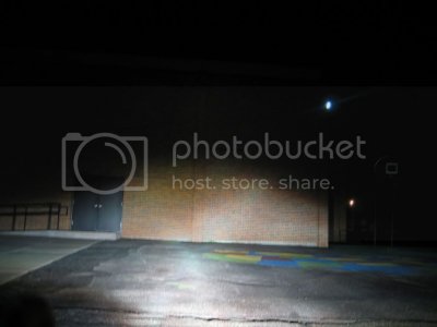

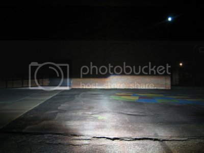

Well the way projectors work is they have a VERY precise cut off line produced by a plate of metal to cut off the light. BUT for some very $$$$ cars that run projectors for highs that plate isnt there thus not creating the cut off line.
For example:

As stated when the solenoid is activated the shutter opens and you have the high beam effect, once you turn off the high beam the solenoid closes the shutter giving you back your nice clean cutoff line. Yes some vehicles have a total of 4 projectors 2 are high beam and 2 are lows, which the 2nd set of lights come on for your high beams and you have a dedicated low beam without a solenoid at all. But no the second set is not really angled any diffrently from the low beams.
