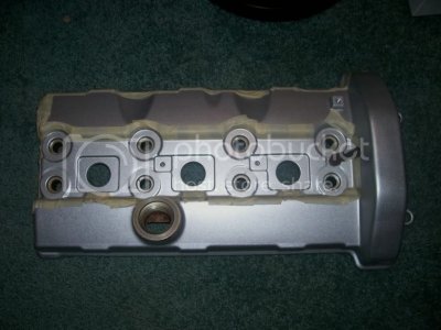

Dont worry, the tape is off there now. I was thinking about painting some red in there but i changed my mind.
Kindve Matches a slicer aay? :naughty:
000 0051
Tell me what you think.

Looks good...what was the tape on there for???
Getting ready to paint some of my own...just wondering. :thumb:
i assume the tape was masking off to paint the middle red.. good decision on leaving it like that :thumb:
Thanks. It looks to good to paint over it.

Looks good! I have an extra intake manifold and valve covers I need to paint up. I was thinking of sanding the manifold down, but it's going to take forever!
Are there sparkles in there or something? Good job keeping it one color, deffintly.

Yes there are sparkles in there. There not real big so they just glitter. Looks sweet in bright sunlight. I cant wait to see it clear coated and wetsanded.

looks absolutly awsome. what paint is that? i would like to do the same.

Just some silver paint i found at walmart. I forget the name but im using engine enamel clear for it.

I was thinking about buying some regular spray paint and doing my intake runners and valvcovers but wont the paint peal off cause of the heat and what not. Or do you need to sand it down first. Iv alwasy been told powdercoating is the way to go if you want it to last longer.

Try to find some sort of engine enamel as this resists heat and oil. But this depends on the color you want. Colors other than your basic orange, red, blue, etc. will be harder to find. But if you can find high heat paint in the color you want, by all means get that. It can stand the abuse. :thumb:
And yes, it is all in the prep work on how it turns out.

In my experience... engine paint is okay but there are certain things you must watch out for:
1.BY ALL MEANS follow instructions for coat/recoat time, if not then it will will not adhere right.
2. Don't build up too much, it will actually crack if you get it too thick.
3. Engine paint is NO friend of brake fluid either. If it gets on the paint, then it will soften it-possilbly making it run, and and for some reason it stays sticky/wet:shrug:
4.It likes to chip, or is more prone to chipping.. and loves to scratch. Haven't really looked into why it does this, possilbly from the ceramic in it, dunno.
Oh well, hope this helps, so that there is no flaming: what I have stated above is personal accounts, not to say you will have the same problems but be weary- I am a painter and know how to prep surfaces and properly apply paint.
