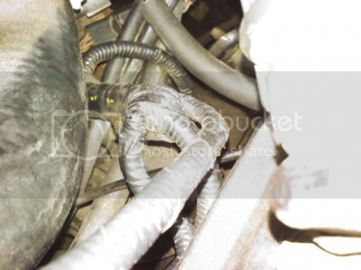

ok all underhood fuses are in good shape, however when I popped up the hood I had an unused clip staring right at me, don't know what it is to.

Unused connector is unused.
Don't worry about it.
