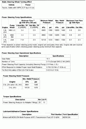

The pump is a very simple design but very high flow. The PS pump on the SHO has over twice the flow rate of the normal Taurus. This due probably to the ZF rack. Could be the rack is developing problems or the fluid is dirty and the innards all carboned up.
What's the PS fluid look like and what kind do you use? I've found that about any ATX fluid will work, synthetic being the best. But it is important to change suck out the reservoir once a year and replace with new fluid.
If the fluid looks like coffee it's time to get to work cleaning it by frequent draining and filling of the PS reservoir until the fluid stays clean.
Ps specs 97 taurus

Maybe they refilled the pump with PS fluid instead of ATF? I'll go look at it once it stops raining.
Thanks for the diagrams/info.
