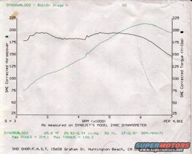

I have an old SHO Shop guide log that details the power gains on popular accessories. I thought I would post them again. The dyno used is a DynoJet model 248C. Its my understanding that this is the best dyno to use because you can achieve repeatable results. The car used is a '89 SHO with 111K miles. A 60K was done on the engine with a leak down test to make sure the engine was in good condition. They ran the engine stock for a baseline then ran the car again after each power mod. Here are the numbers...
Stock HP 183@5900
Stock TQ 189@2800
Added 80mm MAF w/LPM and cone filter
HP 189@5900
TQ 191@4800
Added UD pulleys
HP 196@5900
TQ 198@4800
Added (original style non-equal length) Y-pipe
HP 207@6100
TQ 194@4800
Added Cat-back
HP 211@6100
TQ 197@4900
Added Extrude Honed intake and BBB
HP 213@6100
TQ 202@4900
My dyno sheet with all the above mods plus a quaife.
Dynosheet0002

was all of this done in order?

that's great info, jedhead, thanks for posting it.
the other vital piece of data that needs to be said is that anything within 5 hp or 5 lb-ft of torque is within the variance of testing from time to time.
so the small gains may be real or may be test variation. overall, with all the changes, it definitely shows more power and torque.

The dyno testing was done in the order listed on the test car that the SHO Shop used. I did all my mods at once and the dyno sheet shows the results on my car with about 65K. A 60k was done on the car also. My LPM was tuned on the dynojet.
