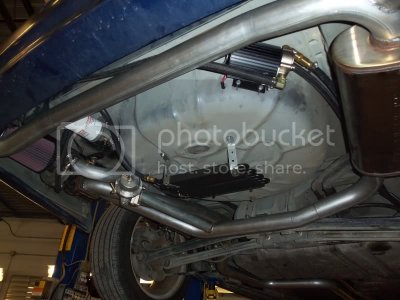

It's bigger than the first ones I used. My prototype was a GT2876 and put 365 and 405 on the tires. This one is a GT30 and is on an automatic. Should be very responsive and make an ass-load of power.

It's starting to get a little crowded under here.

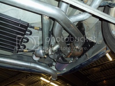

So that just about does it for the plumbing in the back.
