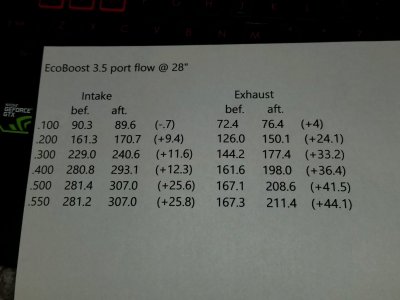

Well here is the Flow Data from the CNC port job. As Matt Pohnan stated stock and CNC ported heads flow passed camshaft max lift, so bigger camshafts would help but unfortunately there’s no aftermarket cam options as they are multi piece hollow camshafts. 8AC0E66A 300F 4534 92B0 46A971C7EF79

Well here is the Flow Data from the CNC port job. As Matt Pohnan stated stock and CNC ported heads flow passed camshaft max lift, so bigger camshafts would help but unfortunately there’s no aftermarket cam options as they are multi piece hollow camshafts. View attachment 83191
I'm very familiar. I saved it to my laptop when @bpd1151 posted it eons ago. I remember being puzzled why a guy would go chasing so much flow at .500" lift when there's only like .330" available. We don't race flow benches, and just about any well known expert will tell you that cfm numbers are the last thing they look at when evaluating a port design. The bench only shows theoretical maximums and is not at all an indicator of realized gains.
If you would, take a look at this video. Skip to the 16:00 mark if you're short on time.
They strapped the biggest, "best" flowing head on the engine and lost power. The big bad papa bear head performed identical to the little baby bear head. Momma bear head was just right for that combination. Why is this? Well, camshaft mainly. Heads that are designed to go beast mode at 8000 rpm aren't of any use on an engine that is timed to tap out at only 5400 rpm. Kinda like having a factory 3.5L head and cam combo that's optimized for 6500 rpm but has to tap out at 5400 rpm due to turbo choke.
On a basic porting where you don't mess with the valve size, I don't imagine it being likely to lose power unless it's a real butcher job. But realized gains aren't a given either. For better or worse, I'm a seeing is believing kind of guy. So until there's real world validation I'll maintain my stance while still being open to getting proven wrong.
