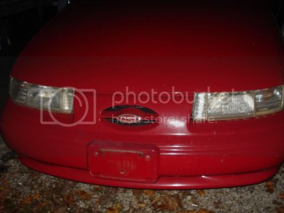

Here are some pics of the damage. I never even had a chance to slow down when I hit the deer. the force of the airbags blew both my hands off the wheel! I immediately went into a skid, and had to get my hands back on the wheel to get it back under control. I managed to keep it on the road and get it stopped. the car had filled up with smoke from the airbag detonation so as soon as i stopped, i had to bail out to catch my breath!

GL getting it all straightened out. I'd hesitate to remove the core support if it can be straightened on-car. Deer don't have a lot of mass, so the squish factor is probably a lot less than you might imagine. I use a 4 foot section of metal fence post to straighten core supports that look pretty unsalvageable. I plant the end on the frame rail and strap the core support to the post about 1/3 of the way up. Standing on the bumper and leaning back, with the top of the post in hand yields surprising results.
