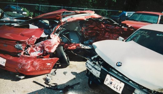

I've already been through a catastrophe back in 2001.

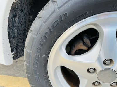

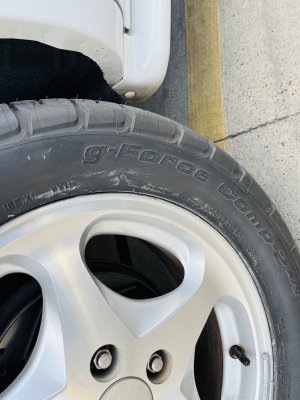

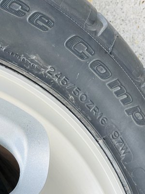

Here are the tires I put onto my SHO.
