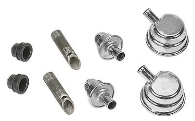

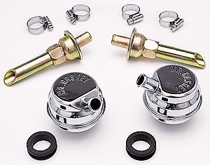

The bung and check valve are two seperate pieces. The check valve *may* eventually wear out. Both are threaded so you can reaplace the valve.
I bought mine from Jeg's. It was the cheaper version that did not have the 'slit' cut into it. I fixed that problem by doing it myself.
7206002
Found here: http://www.jegs.com/cgi-bin/ncommerce3/ProductDisplay?prrfnbr=1783&prmenbr=361
If you look at this next kit (very closely), you will see the slit I am refering to (this helps create more vacuum).
Mor 25900
Found here: http://store.summitracing.com/defau...earchinresults=false&N=0&target=egnsearch.asp
Out of the kit, all you need is the bung, and check valve. The chrome breather is for a american V8 or the like.
As far as the CCV goes. I've run it stock, with a breather, and I now have it capped. I prefer to run it capped or with a breather that lets very little air flow through it. This way you won't be completely sucking from the CCV and you will have some fresh air coming through. You do not really want to 'tee' it in with the PCV to the exhaust. You'll want some fresh air or none. The evac kit will be more flow than you'll ever really need.
I assume the slit on the bung actually goes into the exhaust pipe itself?

Summit sells the Moroso ****** (with slit) and check valve separately.
Check Valve $19.69
Weld in ****** (with slit) $10.69
Total - $30.38
The full Moroso set from Summit is $59.88.
The Mr. Gasket set is $31.99 from JEG'S and it has two ******* and two valves, but the ******* don't have the slits.
I think I might just buy the ****** and valve separately from Summit so I don't have to bother with cutting the slit.
