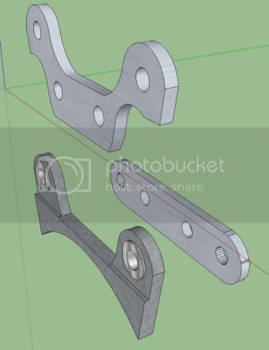

So, in getting back to this, I think I should change direction. I've already got 17 inch rims, so I ought to just use the 13 inch Mustang rotor too. Now, in everything I've read, people say to drill a new hole in the PBR bracket .7" HIGHER but wouldn't that move the caliper the wrong direction?
Since I am owed about a billion hours of laser time for some programming work I did for a buddy, I think I should just have something like this cut, shouldn't I?
SHOPBRCaliperBracket
Please excuse my shoddy SketchUp work. I did this while I was eating my chips and salsa, I probably spilled a little on it. :)

why not use the 13" PBR calipers from a Mustang Cobra?
then its a bolt on..

Yeah, I just read that. I kinda always thought that's what I had, but I guess they are Mustang GT calipers. Anyway, it'll take 10 minutes on the laser to cut some brackets and 8 holes.
But then the caliper cage still won't have a big enough opening to go over the radius of the 13" rotor. I don't think that I have seen anyone successfully use the Mustang V6/GT PBR calipers over anything larger than the 11" rotors.

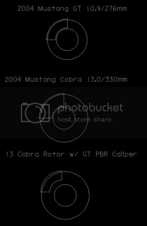

For those, like me, who need a visual clue why this won't work well.
CaliperoComparo
kevinspann
Don't take my advice.
Sep 30, 2007
3,166
1,884
Richmond VA
You can't just make a flat bracket to space it straight up either, due to the offset of the rotors being the same.
Better off just getting the Cobra calipers and brackets.
Yup, that was why the two piece bracket was neccesary.
kevinspann
Sep 30, 2007
3,166
1,884
Richmond VA
Got it. I was trying to visualize how it would all bolt on. It still might work, but isn't worth the trouble for most people.
