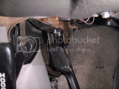

Here is what it looks like with a good regular Taurus pad found and cut off at a junk yard. I installed it with glue, 8k miles and no ploblems.
