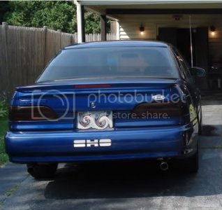

what i did on my 94 moonlight blue was get some 2 inch masking tape put them over the logos make sure you press down so you can see the logo through the tape then get a razor blade carfully cut the tape along side the inside edge pulling the SHO part off the tape then mask up around the logo with newspaper or anything else to cover overspray and hit it with white spray paint
this is the only picture i could find sorry dont have any good ones of the side
