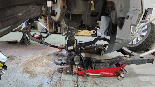

As mentioned, it can be done from jackstands but it is not a simple task. You have to be dedicated. I did it by jackstands. Honestly, the most frustrating part was probably drilling out the exhaust stud that broke when taking the exhaust free from the pre-cats. I had tried to remove the nuts at the turbos to drop the entire downpipe, but it seemed likely they would break before coming loose, so I instead went to a location where the nuts and studs were easily accessible. I also spent too much time trying to get the PTU out without dropping the subframe. Once I decided to just drop the subframe, things were much easier.
Whether or not you can do it depends on your available tools, your patience, if you have at least two floor jacks, and your experience. Probably only you can answer if this is something you can do.
-Rod
