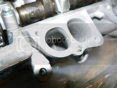

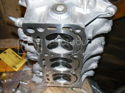

$350 I think mine was.... minimal porting.. came out looking like this.... 3 angle, new valve seals. And usually I thought they cut the valves, and then mildly regrind the seat with an abrasive compound. I did what a lot say not to do, but he trimmed the top of a couple valves instead of farting around swapping shims. I figured once in 200k miles was ok.. lol Others will say no I'm sure...
They are fun to unwrap tho. Worth at least $350...lol
P1000489
P1000496
Plus I didn't have to fart around with what was left of the HG on there either. :)
P1000489
P1000496
Those looks sweet! How's the top end ? :)
Do you say $350, that was for the valve job and the porting/cleaning?
Did he install the valves or was that your responsibility?
-Josh

Any "porting' was very mild and done by hand. And yes, they installed them, checked the tolerances, took it all apart again, adjusted what they had to, then put it all back together again. I should have paid another $40 or whatever it was to have them tested, but I figured they couldn't be "that bad" after all that work.
There is definately more that could be done, but it gets really funny and real expensive really fast. lol
And for the most part, everything I see is up top. Stock 3.0 cam's... kinda runs like a pig off the line... could be my 18's.. but runs like **** up top.
