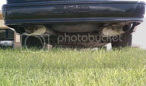

I have a catless SHO with a big resonator and 2 07 Mustang GT mufflers. What is weird is my SHO has a deep growl. Tim(Toolman) says my exhaust sounds great!!
DSC03260
The mufflers do hang pretty low but I have gotten use to it.

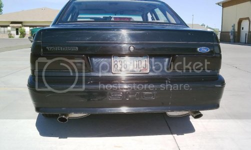

I have a set of '05 GT mufflers just put on my '89 and I love them. With the car being black you really don't notice the mufflers being a little lower because it just gets washed out when you look at them. The sound is much deeper & throatier than stock and I don't get any rasp from any RPM range.
