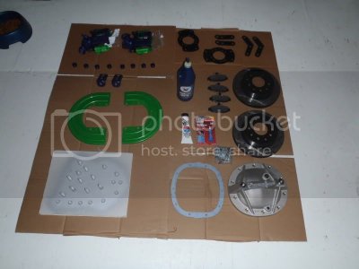

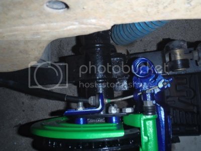

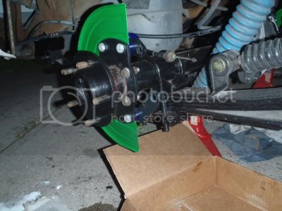

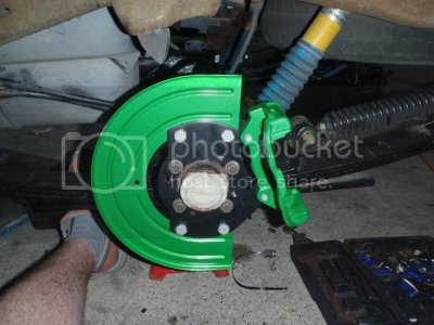

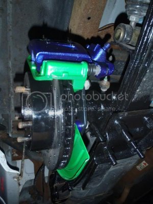

it is so funny to see what kind of combinations you can come up with to put together to stop a car.
I just did a drum to disc conversion on my dime (S10). It has 88-91 Lincoln calipers, has splash shields from a Ford 8"/9" axle, has astro van brackets for mounting the calipers, and T-Bird brake pads...
P5290714
P5310864
P5310874
P5310858
P5310876
just goes to show you... you don't have to be brand/make specific to get the end results. Parts don't know they are GM or Ford or Audi or whatever..
BTW this is the SummitRacing disc conversion kit that is actually made by SSBC.
