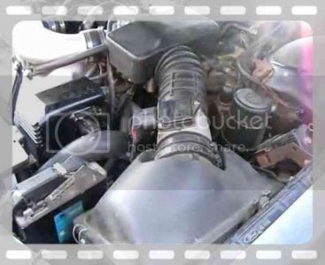

Let me see if I can find a clip of the noises mine was making before I yanked it out.
Th P1020211 1
That was my noise... swapped out another transmission, and its gone. Still have yet to get Bizzy's hands on it to see what is really going on in there.

Thanks for posting the video. I listened to that earlier. The whine in your vid almost sounds like too tight of a timing belt. Been there once as well trying to reuse the tensioner and mucking up the tension procedure. I can definately deduce the noise I'm hearing is related to the movement of the car, and not the movement of the engine. It's hard to diagnose a noise from video sound, but after listening 10 times, might be the same deal. Sounds like your noise continues even with the wheels stopped though?

And yes, the whine was actually from my alternator. :) It's one of the peices I reused, because before my car origionally took a crap, I had it rebuilt. But in the 3 years it sat idle, and rusting.. the bearing got noisy. It's not nearly that loud now... almost non existant.
Now the noise would stop, IF I got both wheels stopped. I actually think mine was the diff bearings being shot, and starting to wobble the diff. Spooky as that sounds. I wondered about a pin coming out, but honestly I haven't even taken it apart to look at it. Didn't want to disturb any evidence, so Bizzy could fix it a little easier maybe?
