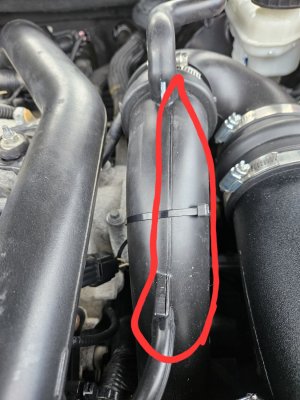

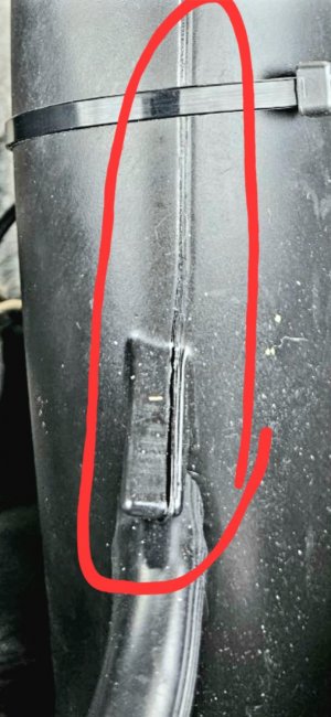

I dont have any close up photos before the zip tie. Of course. Because why?
Now I need to add more zip ties and maybe some sealant until I can get a new pipe.
Need to check options.

Double check and make sure it is actually cracked. Looks fine in that new photo.

I feel like its fine because the single ziptie is holding it together. I'll remove it and see if I can spread it by hand.
I have some good sealant that I can use. I'd like if I can to split it a bit to apply and then clamp it back together and hold with more zipties.

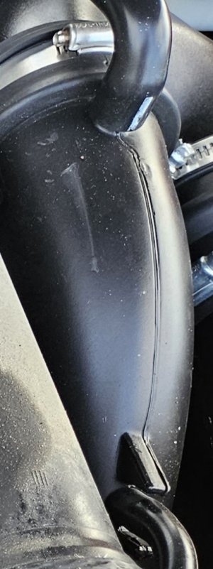

I found a non ziptie photo of the crack hanging out in the corner.
Luckily my phone took a decent photo to zoom in on. Ill include the whole photo.
This was first cover removal.20230829 174840
zoomed in for this. 20230829 174840

Oh wait. This is intake. A crack wouldn't cause boost problems being pre turbo. If anything it would be sucked closed. Or if open too much cause extra unfiltered flow.

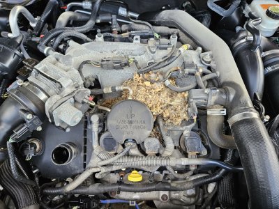

This was first cover removal.View attachment 88507
zoomed in for this. View attachment 88506
Top photo looks like a critter took up residence under your hood (looks like a mouse nest?). Check your wires for gnawing/breaks that would make the connection go intermittent. I had a rodent crawl into the engine bay of my Vette and gnawed thru a wire that made my AC stop working. Drove me nuts trying to trace down the "leak" when the day before the A/C blew ice cold.
