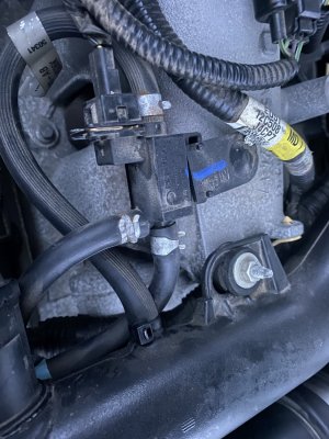

Check the zip tied hose in the pic to see if yours is detached.
I've seen this exact photo and suggestion while searching the issue.
I actually pulled this hose allowing more movement in the charge pipe to get better access around the rear plugs. It was on well when I removed it and went back on solid. But it will stick in my head as a potential issue down the road requiring small clamps.
