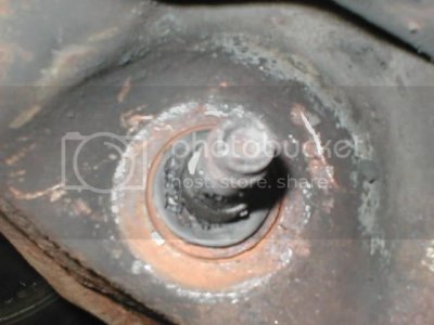

In an effort to find noises in the front. I decided to check the cups on the front of the strut rods. I started with the driver side. The rod itself looks like it is newer than the pass side. I had to use the heat wrench carefully to be able to break the nut loose. After all that I get the bushing off and it leaves the smaller part inside the cup! :doh: I check the edges of the cup and it looks like the bottom edge could use a weld... Now I gotta dig out the rest of that half of the bushing and get another one... Any ideas to make this easier? Ive got it up on ramps like Scott did to keep the suspension loaded.

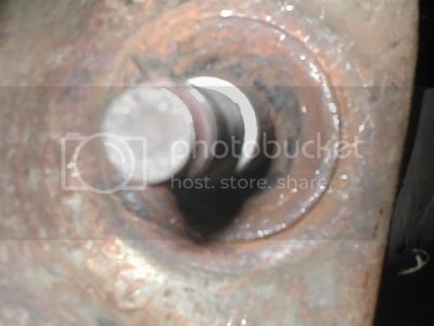

The verdict is in.

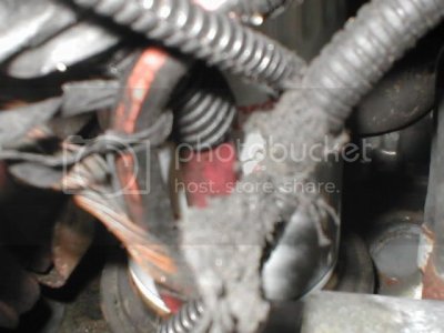

Here it is, driver side looks "okay" I'll run a weld on it. The pass side is done... After much burning rubber and impact gun I removed the nut to find the ****** is gone... Damn, I wonder if I can cannibalize a good cup out of another subfrome. I'm going to Dans tonight, I'll grab a s/f and bring it home and give it a try. I am really running short on $ til I start my new job and get this thing on the road... BTW, I found an alarming wire with no insulation. :omg: I traced it can any one else guess?
Pass side: Pscup
Driver side:Dscup
And the "mystery wire" for extra credit :biggrin: :
Altprimary

IIRC, there's a Moog kit to repair that broken cup issue on the subframe. I don't recall the part number, though.
On the wire, it looks like the starter soleniod wire. If it is, and it shorts to ground, you're gonna have a world of fun on your hands. I'd take care of that, and soon.

Yeah it looks like the wire for activating the solenoid, I found mine starting to peel back also, I cleaned it up well and used shrink tube. If its the wire thats plugged on the solenoid its only hot when you have the key in the start position.

I'm trying to stay away from dropping $150 for that right now (later) I'm gonna run a bead on the driverside. I got a subframe from Dan tonight and I'm going to pull it apart this weekend and see what I can do. I need to do the rear bushings on the pass side one anyway. I may even get lucky and be able to weld the pass side one as it looks pretty flush... Just have to get the rest of the bushings out of the cups... The wire goes from the solenoid to the alternator. Im gonna clean it up and tape it up for now. Glad I didn't accidentally grab that critter put it against the frame! :eek: Looks like someone kinda folded it up so it wouldn't hit anything.

I tore apart the other subframe tonight. Man this one the cups are in awesome shape, too bad its an mtx one... Looks like they may have been welded better at one time. I'll clean those spots up tomorrow real good and see how good they are. Looks like I'll be doing a little welding on mine... I was able to take off the control arms and strut rods (man these were a ***** coming outta the hole in the frame...) Was able to save the bushings that I roasted in mine. Control arms and strut rods aren't side specfic correct? As far as the control arm bolt bushing to frame. Should it be lubed in any way? And the control arm/strut rod bushing.

If that's an ATX, then the wire with the missing insulation connects the alternator output to the starter, which then feeds up to the fusebox. Mine was also missing an inch or two of insulation on this wire, but since it was a black wire, I didn't think too much of it (thought it was a ground). Found out during my tranny swap that indeed it was a POSITIVE conductor that carries at least 130 amps. Get it wrapped up right away.
