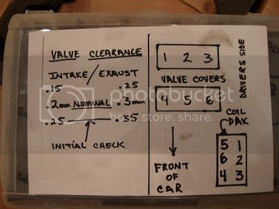

Firewall Firewall
1 - 2 - 3 Engine 5 | 1 Coil Pack
----------- Cylinder 6 | 2 Cylinder
4 - 5 - 6 Sequence 4 | 3 Sequence
Radiator Radiator
is this the correct firing order
