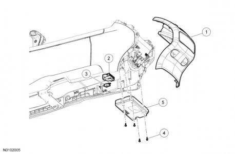

You likely have a bad APIM. APIM is the "brains" of the SYNC system.
Use FORScan or a high level scan tool to check for DTCs in the APIM.
Looks like the APIM is located at the rear of the console in 2010. #5

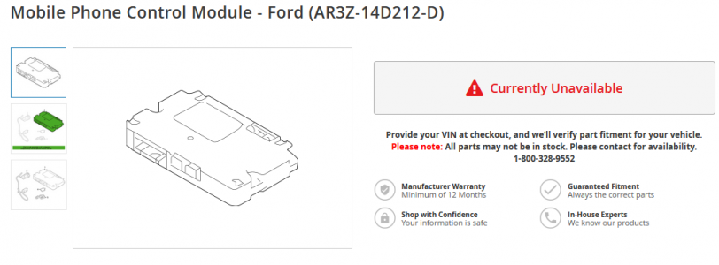

AFAIK, a used replacement, part numbers matching, is plug and play. A new APIM would have to be programmed by a dealer. Here is an example of what you are looking for. A scan tool may be able to get the part number or you'll have to remove the APIM to visually check it.
Near as I can figure, this is the replacement part number. It will not be the part number on the module itself. If it was available from Ford it would probably be $500 or more.

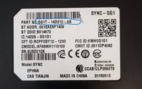

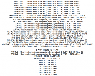

Found this interchange chart. Not saying it's accurate but, may give you an idea where to look for a module. The two that are listed for 2010 Taurus, you can ignore the last letter which designates a revision level.
