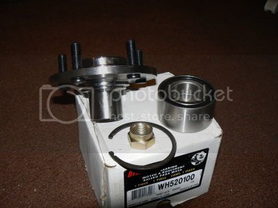

Yes, those are the right ones for $70. You will probally still have to get them pressed out, and back in again. You will need to get your spindles off the car, and take them to any repair shop around you. I would find some place that does alignments and that sort of thing. Not just an oil change place or something. But the smaller shops are where you want to go. The Ford dealer said they wanted like $250 to press them in and out. But with a little bit of calling around, I found a shop to do them for $30, I waited about 20 minuites, and they were done.
Here's a pic of that 'repair kit' your talking about. The snap ring deal there holds the inside from pushing inward, and that big nut keeps the axle in the hub. Make sure you have a washer there too, if not let me know, I have to order that washer from O'Riely Auto, as they are the only ones I have found to have that washer.

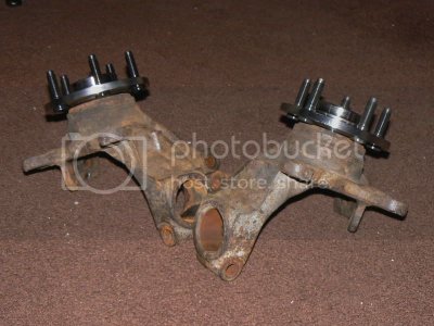

Pics of the new bearings in the hubs.

Also if your doing all of this to your bearings, now is a great time for a brake upgrade if your so inclined. Depends on what year your SHO is, but its not much for some used knuckles, and brackets. :)
