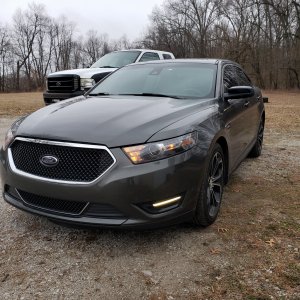

as we know the car was a highway car, how else could it have gotten 107k miles in 5 years... well the front end does NOT show a highway car. Im betting its a new bumper or got sprayed, but no signs of work done!

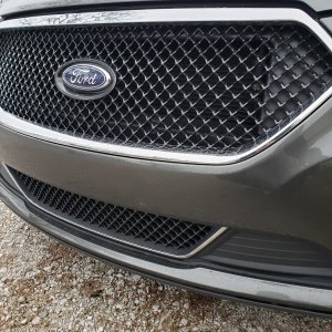

I was thinking that when I saw the new struts. Maybe a little repair but struts could definitely wear out over 100k. I think that car would look great with that chrome around the grill blacked out.

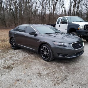

oh i havent even begun with cosmetics.... but this summer all the plastics are coming off and the underneath is getting undercoated and fluid filmed... I will not have this car rust out on me... IF you notice my Super Duty is a Panda right now since I put a new cab on it due to rotting out...

Wow. Didn't even see that. I grew up in the rust belt so, now that I'm not living there, I don't even consider buying any vehicle with rust. Over it.
