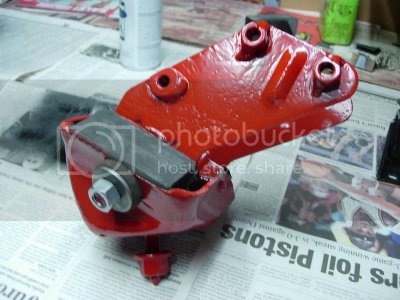

stock frt & rear SHO mounts are a 'bucket & horseshoe' design utilizing a urethane bond to hold them together. Most failures occur when the bond between the 2 pieces fail from corrosion &/or extreme twisting. The mount MUST twist to absorb shock & not break other components. Most stock mounts I have seen have very little urethane covering the top of the 'horseshoe. Its not really needed as the bond is designed to be between them. BUT! when you re-enforce a mount by compressing it & replacing the small limit pin with a larger bolt or tube, you may now have a metal to metal condition causing NVH! A 3-5 mm piece of firm rubber should be placed between the new limit pin & the top of the 'horseshoe' to avoid this! The 'horseshoe' must be isolated from the bucket. You just want to control the twist & limit its lift. The best & easiest way is to bolt them through with 2 bolts in clearance holes & thick (15mm) rubber bushings under washers.
DSCN0654
sperold
Last to Know
Aug 25, 2008
3,753
1,440
Ontario Canada
Has anyone come up with a better mount? One that is conventional and uses a typical pin type connector, that can still be purchased.
I see a lot of posts of people putting different subframes in these cars, have any of these people solved this mount issue?
Any pictures?
If someone came up with a mount for a hot-rod that looked like this, his friends would deny knowing him!
