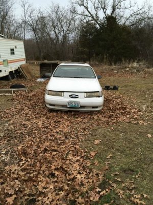

Just completed a deal to pick up a 1993 Taurus SHO. All original, all the parts where there, with the exception of one 'SHO' center cap. I'm not going to lie to anyone... it's in bad shape. I wasn't even really looking to pick up an SHO, but this popped up on craigslist for dirt cheap, and I'm a sucker for a deal. Here's the catch, it won't start. It turns over, but won't start (and it has been sitting for 4 years). I did some research on the drive up to look at it, and it sounds like either a cam sensor or crank position sensor has gone bad. I'm not too worried about it, seems like those sensors aren't too expensive and if that doesn't fix it, or it's got a knock or something, I'll either sell the car or part it out.
Exterior is white with black leather interior. 3.2L engine with the automatic transmission. I wish it was a manual, but hey, it was cheap. Stock wheels and body isn't too beat up. High mileage, 209K. Probably pretty worn out.

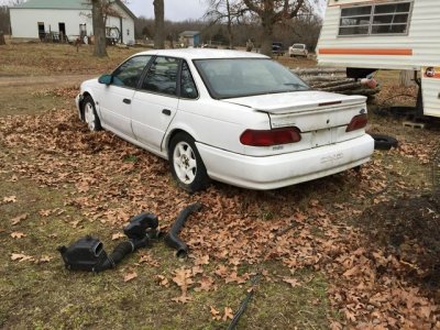

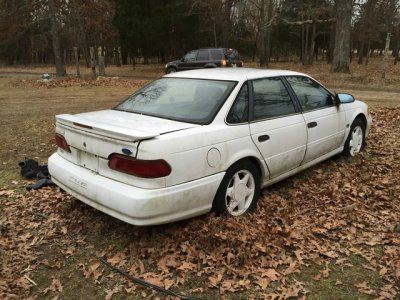

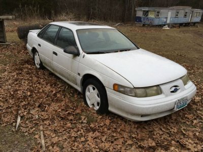

I know it looks pretty thrashed, but I think it will clean up nicely with a good detail. Sorry for no interior pics.
