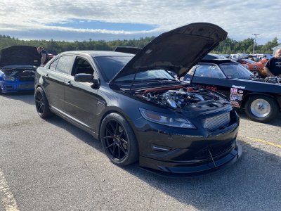

I did my own, it’s just a matter of choosing one, get a universal IC piping kit and various silicone couplers and clamps and you should be able to make nearly anything work. 089E26A1 9544 4336 9BFB F1D1AE86494287F0A8D8 F3A6 450E 9CA7 38C80342C7DB
This is a TreadStone TR10C rated at just over 1000 cfm good for up to over 650hp. Now too small for my needs, up for sale.

I did my own, it’s just a matter of choosing one, get a universal IC piping kit and various silicone couplers and clamps and you should be able to make nearly anything work. View attachment 84978View attachment 84979

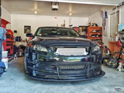

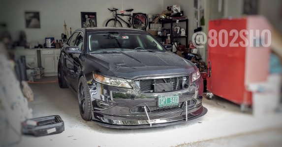

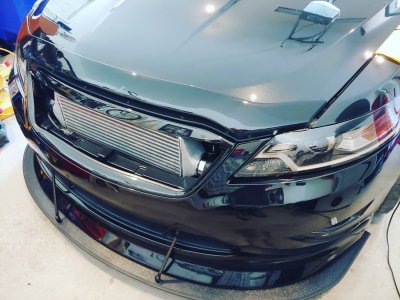

Mine can fit the grille, but I deleted the grille before adding it and kept the same grilless look.
Before front mount

After front mount

Nothing protruding into the grille areas
