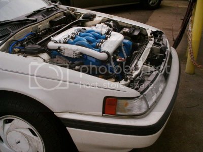

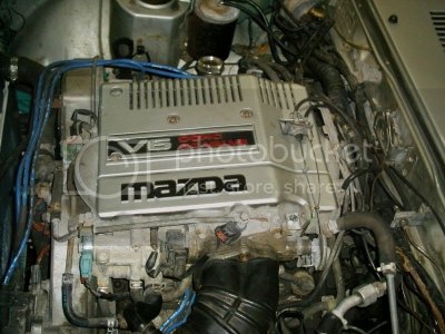

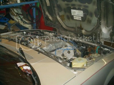

SHOs008
SHOs007
SHOs006
SHOs005
some older shots.
Dec03 003
Dec03 001

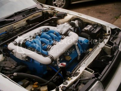

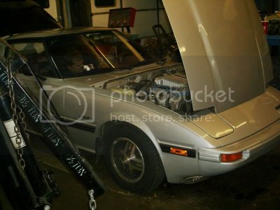

and another of the same guy's toys...
SHOs015
SHOs014
SHOs013

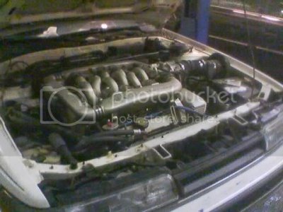

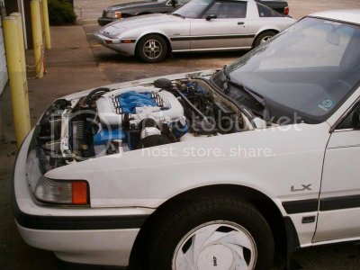

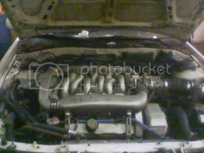

I can't for the life of me remember if he used a SHO subframe or not, but I know the 927 (RX-7 with 3.0 V6 out of a Mazda 929s) has a turbo II rear suspension setup with custom mounting points. But he most certainly used the SHO tranny in the 626.

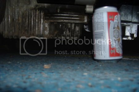

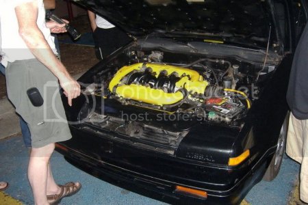

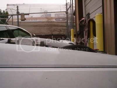

and just for fun, a SHO powered Nissan Pulsar, also with the SHO MTX-IV...for those who remember, this was Secret Project X5.
Openhoodattheconvention
it has some clearance issues.....
Beercanasareferancetomygroundcleara
I think he was using a hybrid axle in the 626...or possibly a SHO axle. I know we had to create some axles for the pulsar using SHO inners and nissan outers with modified lengths. How difficult would it be to use the spindles from the SHO on the MX-6? how different is the mounting setup?
