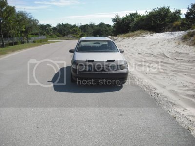

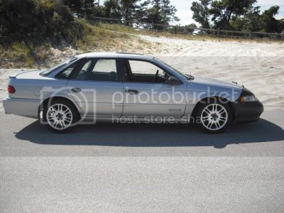

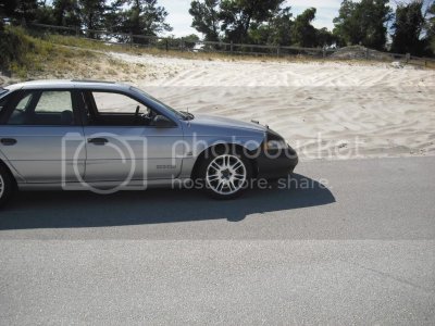

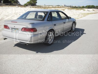

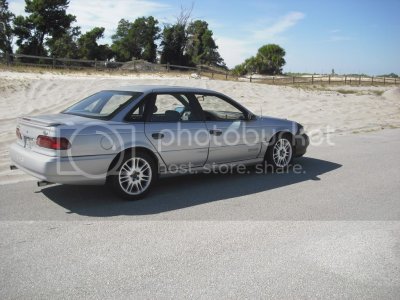

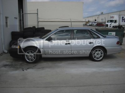

Moog gen2 front springs, 2 coils removed
93 MTX
rears are stock for now, I ran outta time Friday......
I kind of like the raked look, but the rear defintely needs to be lowered a half inch or slightly more

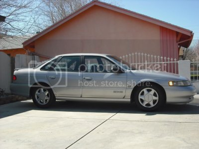

here is a picture with all stock springs for comparison
CIMG0970

very stiff, thing of it is, it feels 10x better now, I even reused the old used sensatrac struts..... figure that one out... it was more bouncy with the stock springs..... now it feels controlled
turn in is better, but defintely need to slow down for bumps
I won't be removing anymore off the front, I already can't park it anywhere, I used to be able to run the front wheels to a parking stop, now the bumper won't clear
defintely dropped 2-3inches wish I had measured it before and after.... I was kind of in a hurry though squeezing it in at work between jobs. notice how the top of my wheel lines up with the middle of the 24v DOHC emblem in the pics.... the old one it was higher then the wheel by a good amount..... even the lower trim pieces started off higher then the top of the wheel
also those are 235-45-17 tires
the old wheel gap was obscene

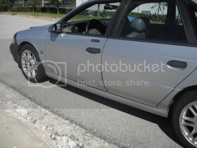

Reminds me of dads 95 ATX. His car also had the raked look. I'm not sure what springs it was on but they were not altered.
DSCF0106
It looked great but I DREADED backing up in that car, I could not see anything over the trunk and I have bad depth perception as it is!

It should drop a little more though..... I didnt always like those wheels, I actually think they are dead sexy with that drop!
