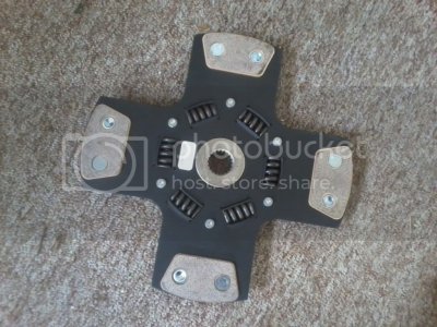

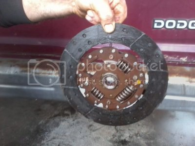

Here is what happened and not the first time on this car: one late evening when i was backing out of my driveway, something popped and clutch pedal became hard and my car wouldn't come out of gear. I rolled down, stopped and shut the engine off. Put it in Gear, started the car and it started moving. I thought it was one of the springs on a disk that popped out. The reason why i thought that is that HoustinoJillian, who was one of the owners of this car before had exactly the same problem, just under different circumstances.Had a doubt that it could also be TOB. Here is what i saw today, when I picked the car up from the shop

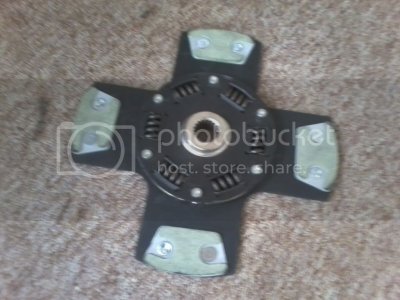

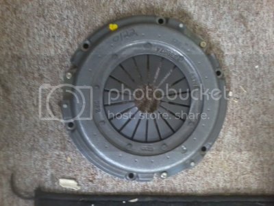

Pictures above are CM stage I, i think. My Girlfriend says that this happened because i was drifting in the snow, which i can't belive could've happened in the snow. Here is what I bought and had installed:

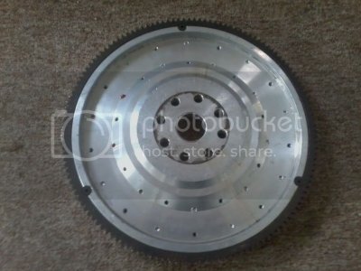

Is that pressure plate reinforced? also that looks like a aluminum flywheel, those are not recommended to be run with reinforced pressure plates. BTW 4-puck is going to be chattery.

well, the company H&R Clutch, that I bought it from, claims that this is better PP than stock. Disk is Kelvar and Ceramic with 6 springs. feels good except at the top when about to let go it feels like it want to be dropped. Yes flywheel is SS aluminium.

it is an interesting clutch, at least was to me when i first got it. I called the company right back asking if they sure it was going to hold all that different manner of my driving with so little of material on it. They laughed and said yes and everybody calls back with that question. So, we'll see. Break in period is around 400-500 miles, but so far it didn't slipp yet and shifting is nice too, except for when i have to take of in first gear, right on the top of the pedal.

It's going to be a **** to drive with in any appreciable traffic with that 4 puck. Stop and go happens enough on the Sprain, you'll see what he means soon enough when you're caught in it one day.
Using a HD pressure plate is not recommended with the aluminum flywheel because the increased spring weight is enough to change the geometry of the flywheel when depressing the pedal.

I didn't understand what spring weight are you talking about. Is it disk springs?

And I wasn't talking about the disc spring (what ejected on your failed clutch disc), but the Pressure Plate spring. Many HD plates come with a much heavier spring.

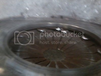

That's a bone stock Valeo cover and pressure plate assembly. Even in your blurry picture, I can see that it has stock Valeo square-end straps and the way the strap rivet heads are set is factory Valeo. The little round indent in the middle of the rivets on the pressure plate ears also tells me it's factory Valeo.
If the diaphragm pivot rivets have a little "V/A" embossed in the heads, then this whole cover is bone stock Valeo.
I've drilled apart and rebuilt more SHO/Valeo clutches than you can imagine, I know what they look like and I know how Valeo builds them, right down to the drill sizes needed to cut the rivet shanks out of the Iron.
Here's my prediction: With that aggressive 4-puck disc and the engagement shock loads it imparts to the pressure plate, the pressure plate straps on that cover are not going to live long.
Enjoy that grabby clutch while it lasts.
And on drifting in the snow... I hope you have a TBD or an LSD, because if you don't you're quickly going to find out what SHOBoom! means. Not to mention that your new clutch will be ruined by the newly liberated transmission fluid in the process.
A question, do you mean the higher spring forces (not weight) cause bending of the flywheel and thus alter the stack height/release?
