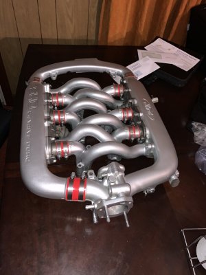

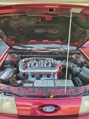

I painted mine…
They is paint. Just steel wool it. Best way to clean up al you min ee um
Takes awhile. Cast aluminum paint high heat. I did valve covers too same same.
Both pics are old. Car is repainted also

Looks good but that almost looks too silver, but I know a photo can be deceiving.

I don't know if there is an oem match. Your options are paint, powder coat, or polish. Polish looks kick a$$ but I would never have the patience to do it or even upkeep after.

Looks very nice! And then you look around at the rest of the compartment and try to figure what should be cleaned up next because it makes everything else obvious.... mine is the same way!
Thats the worse part. Makes the rest of the car look bad. Same when i painted the car. Beautiful! But then the door handles and rubber triangle around back quarter panel window stuck out real bad.
May be able to do high build on the door handles and just have them flat black with no texture. Still it will look funny. No winning…
