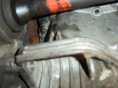

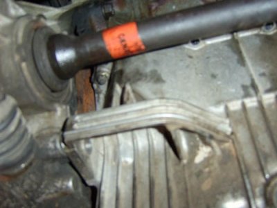

Okay so after my oil light came on one day last week, I immediately parked it at home and decided it was time to change the rod bearings. It has 282K miles and I had already bought the bearings and gaskets, so I was set.
I removed the starter, Y pipe, and all oil pan bolts/nuts except the last one was stripped. And out of all of them it just had to be the worst one in the toughest place to get at. I barely managed to get a wrench up there after it wouldnt budge with the socket and that was a no go. I can't fit vice-grips up there.
What are my options?

A U-joint with a socket on it and an extension on the ratchet works for me. Do you have the nut rounded off now? (you could always pull the tranny to get good access to it lol) Maybe you would like to try one of them bolt out things they sell for that attached to a U-joint to get up there?

Take a clean socket and J-B weld it onto the bolt head after you cleaned it with brake Kleen. Use a stick to hold the socket in place until it hardens up. Use a universal joint adapter for the extension and go to town on it.
