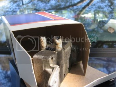

Got the right part and put it in with no problems. I don't an intermitant low idle but now it seems to run with a low idle as soon as it warms up and there is a noticable drop in power around 2000-3000 rpms.
I have not cleared the codes or reset the idle yet, but I will tonite. Here is a pic of the piece I took out:
IMG 0294
It looks pretty nasty.
Is there anything else I should clean out or do before I reset everything? I would like it to be back to normal :)snicker: ) by this weekend for a trip to Jax.
