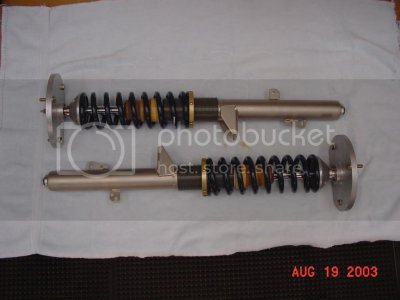

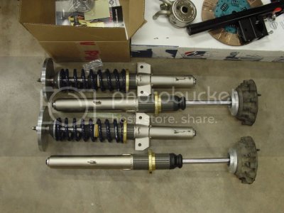

Here's a few more pics of my SHO coil overs.
This one shows the complete front coil over assemblies on the left, and the incomplete rear assemblies that used a modified rear upper mount. I ended up not liking the modified OEM upper mount because it limited bump travel and forced me to use an 8" spring (too short...), so I built a few, but abandoned it. It was also expensive and hard to build.
DSC00075
Here's the later redesigned rear assemblies with a billet upper mount that allows using a 10" long spring, so the rear gets all the suspension travel without any danger of putting the spring in coil bind. A side benefit of adding bump travel and allowing a longer spring is that it moves the Koni adjuster upwards so it actually pokes through the top of the strut tower, no more hunting for it down inside the hole.
New rear strut assys
The strut housings were prepared by cutting off the spring perches, welding on a short tubular collar to support the threaded collars, then the housings were blasted, chem cleaned and electroless Nickel plated.
