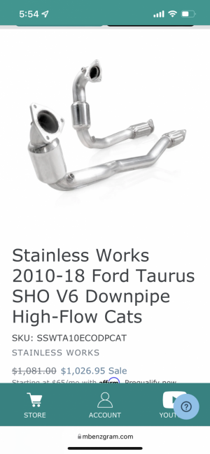

Also your talking about those pipes?

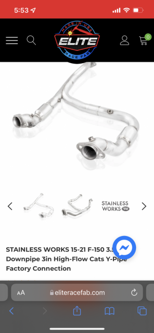

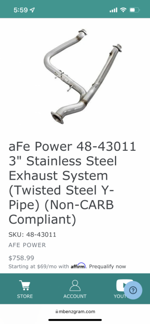

Which one you will think will be the best to use?
those are all F-150 midpipes minus the one Stainless Works set. The rest aren't compatible with our cars, they are made for a longitudinal engine frame.
