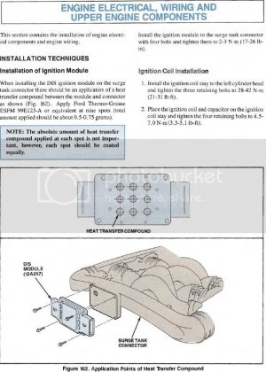

I applied it like the shop manual said. I can't believe they go into detail about the procedure for applying, with weight too.

The paste on the back of the DIS is to conduct HEAT, not electricity. The heat paste/dielectric grease thing has been debated a peskillion times, but according to this:
Untitled
you need heat sink paste. Yes, others will argue. I don't care.
And no, not having heat sink paste will not cause the DIS to immediately fail. You can run it for at least a few hundred miles with no paste whatsoever before something inside melts.
