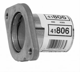

Hey all I have a third cat deleted I have a new stock flex pipe.
I need a piece that would bolt up to the stock flex tube. Im guessing it would be called an intermediate pipe?
something like a ****** that's flush and a basic 2 1/4" tube coming of the back of it.
I dont really wanna weld to my new stock flex pipe.

I think it will have to be a custom made job, as you are, if I understand correctly, trying to put in a pipe that connects up with replacing the third cat? Totally illegal in many states and provinces, so not a commonly available part.

So that pic you posted. that won't work because...wrong ******? I haven't had a GenIII in a long time so I am trying to picture what size/dimensions ****** config and pipe length you need. I remember going to an Autozone and looking through their exhaust parts (Walker at that time) catalog to find what I needed. It's harder to come across that on line vs their plug and play oem fit replacement products.
The pic i posted im not sure what the dims are but if I could get the same size ****** longer tubing thats 2 1/4. i could just gasket it and clamp it. call it a day

if that 2 bolt ****** is the same as the our stock flex pipe i'd just saw that part off that aft of that ****** and let the gasket do its job. would be easy to make that work if that ****** is somewhat the same size
13,266
There is no way to know if the ****** mates perfectly or not. Maybe if there is one in stock somewhere you can bring a template or measurements to check it. I would guess the chance of it being close are better than average because it is a designated t bird pipe for a 96 and they may share a few components. Maybe..
