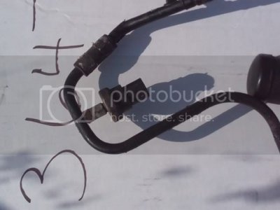

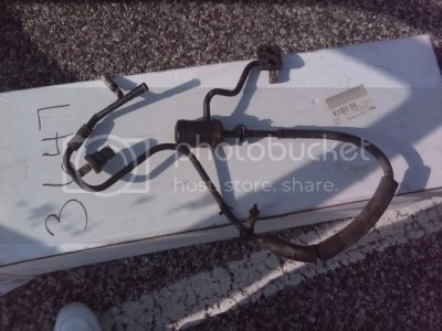

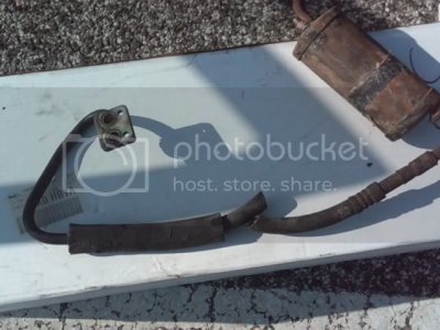

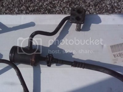

All autoparts stores show the wrong parts for the car. Here are some pictures of the hoses. Sorry but they were taken by my phone. I might have to find a local place that can make some for me.
Achoses001
The Napa hose lacks this fitting and has a extra hose off the mounting block.

And this hose to the drier

If the metal ends of the hose are ok you can have it rehosed. I work at an automotive a/c shop and that is what I did with mine. A a/c shop that does a lot of a/c work on busses and semi trucks should have the tools and hose to do the job.
