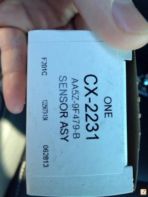

We're you sent any other tunes like a 91 octane or 87 octane? Check the part number on the map sensor, I remember reading on here that someone got the f 150 version, then I would blow up Livernoise phone until that crap was fixed. Torrie could have u a tune within an hour if it came down to that as long as your tuner is compatible

They sent me a 91 octane 3 bar map sensor and a 93 octane 3 bar map sensor tune. It throws all the codes with the 91 octane 3 bar map sensor. Haven't tried the 93 octane tune yet scared too. I will double check the part number on the map bar sensor but I'm pretty sure that's it is a 3 bar map sensor and don't worry I plan calling them today and getting the problem fixed today

That's the map sensor that I bought for the car.

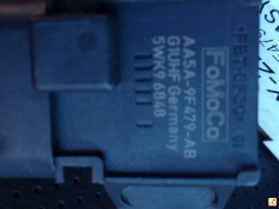

I will put money on the fact that you simply placed the 3 BAR in the wrong place @AndrewGanoe32 it happens often.
Did you get the CEL after you loaded the 3 BAR tune? Where did you install the 3 BAR MAP sensor that you purchased? If you installed it near the throttle body that is your problem.

P0106 is for the MAP sensor...Also the symptoms are very similar to what happens when you have a 2 bar map sensor installed or it's in the wrong place. I'd bet that is your problem or somehow your new sensor is already bad. Make sure you replaced the one ON TOP of the manifold. It's circled in RED on the PIC.3bar map

I want to take the the time to thank everyone for helping me out with the car everyone as right the map sensor was place in the wrong place did everything livernois told me to do. And now the car is running really well.
